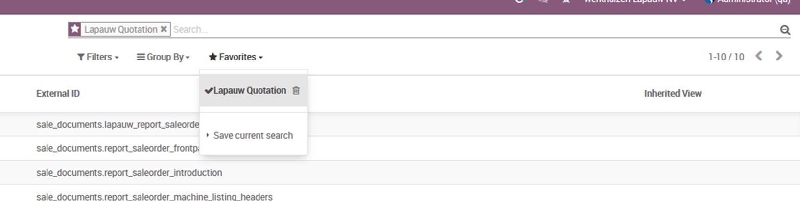

  You cannot access these terms from the sales menu, the translation process is a little bit complex, but I tried to simplify it as much as I could. Please follow this little guide-through for translating the Lapauw Quotation. Steps for translating the Lapauw Quotation: Enable debug mode Go to Settings (on the main dashboard) / Technical / Views (or use this direct link: \http://91.134.136.87:81/web?debug=#view_type=list&model=ir.ui.view&action=25&menu_id=4 ) Enable ‘Lapauw Quotation’ under Favorites
  • Enable debug mode
  • Go to Settings (on the main dashboard) / Technical / Views (or use this direct link: \http://91.134.136.87:81/web?debug=#view_type=list&model=ir.ui.view&action=25&menu_id=4 )
  • Enable ‘Lapauw Quotation’ under Favorites
  • You’ll need to loop over all the entries shown, so open the first one, follow the steps hereafter and come back to this point
    • Click ‘Edit Translations
    • Edit the Translation Value column when needed, you can add extra filters here, so filter on language or on specific keywords
    • When done adjusting the terms of this entry, go back to the ‘Views’ overview by using the breadcrumb, open next entry and click ‘Edit Translations’, …
